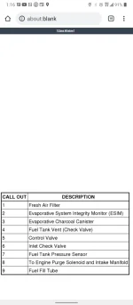

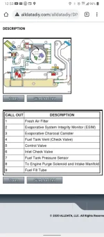

Here's the diagram from all data. Looks like fuel pump assembly but it's not very clear either 🤷
Unfortunately that's so small on my screen I can't discern anything useful from it. I'd definitely start with replacing the carbon canister.

You can't click on it? On my end I can click it and zoom in as necessary
Definitely looks like it passes through the assembly. What part is 16? It looks like fuel could flow through into the carbon canister through 11 if somebody filled it right to the brim.
16 would be the grade vent valve. I don't even top off so if things are acting properly it shouldn't get high enough to effect 11. I let the pump click off and that is it.
