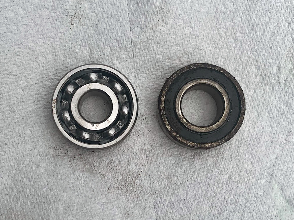

So the bike vendor sent replacement bearings. I warned my friend that there was only a slim chance they'd sens the correct bearings. They didn't. The original bearing is 20x42x12. They ordered him five 15x42x13.

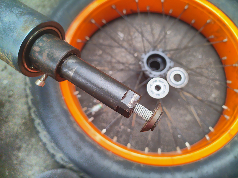

When I removed the wheel and the original bearing I realized that one of the two screws that held the collar that's on the axle between the wheel and the axle bearing had broken off. More joy. I guess I'll try to extract and replace that one. Or maybe just leave it as is. This trike is doomed.
Old bearing and new bearing. Not only was the bearing they sent the wrong size but it was missing the dust seal on one side. I told him what bearing to order. The bike will be out of warranty in a couple of months. Not that the warranty has been any good so far!

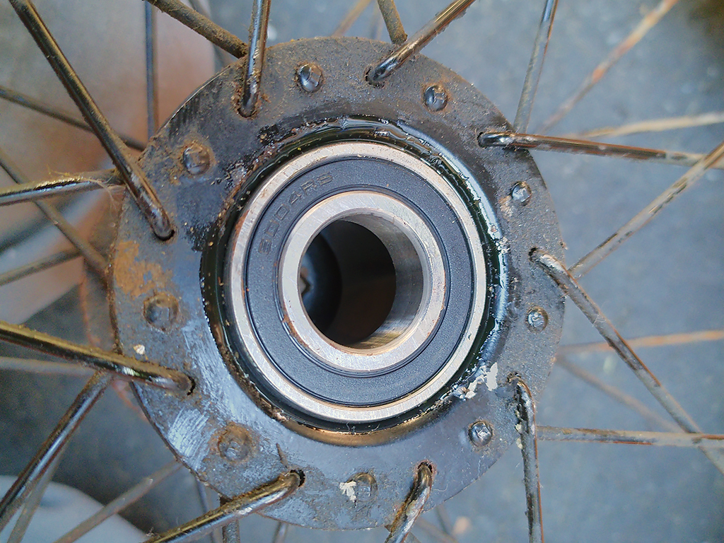

I installed the new bearing into the rusty less than the one-year-old wheel. Pearls before swine. At least thing is running again - for now. I saw more sludge on the chain and derailleur.

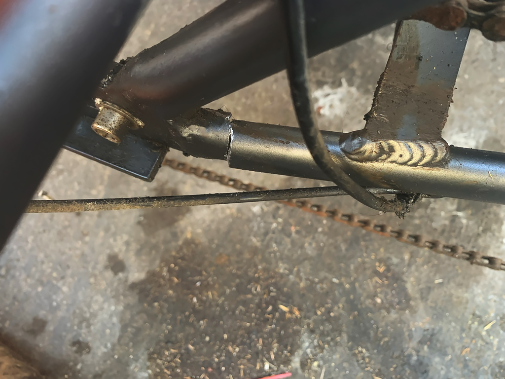

Oh snap! My friend sent me a picture of his latest mishap with his Chinese e-trike. The chainstay snapped. It snapped of course while he was riding it. Like the Titanic, his ride was listing heavily and I'm pretty sure the left chainstay side suffered significant stress from being twisted when the right chainstay snapped. This is an aluminum frame. Pretty thin metal. Consider trike and rider top out at nearly 400 lbs (at stillstand and not counting inertial forces).
In my opinion, there's only one way to fix this and it's not worth it because getting this done will cost too much and that trike is going to suffer other structural failures soon anyway. One could replace both chainstays if one had access to a frame builder who's willing.

That's what worries me. The chainstay has been epoxied. I'll see if I can get him to send me a picture.
When I was a kid I had a Huffy bike whose frame cracked where the front downtube joined the bottom bracket. My dad epoxied it with something similar to JB Weld, but it was more than 40 years ago so I don't know exactly what product he used. That bike broke in half while I was riding it a few weeks later.
PS: on the other hand, a friend of mine has a steel bike frame whose chainstays cracked similar to the photo you showed. He went to his dad's metal shop and they fabricated a bracing cage and welded it into place.
I wouldn't advise fixing that, but if I had to, I'd jam a steel rod of appropriate diameter through the center of the tubes so it press-fits together with a friction tight fit. Then wrap it with something. Maybe fiberglass cloth saturated with epoxy similar to some boats & airplanes. The epoxy cloth holds it together and the steel rod inside bears the load.
I'm pretty sure that a steel rod insert (or an outer steel sleeve) will create new stress points and eventually a fracture where the rod/sleeve ends. Also, the other chainstay was twisted longitudinally and is on limited time also. I am convinced the bike was carefully designed to make it just past the 1-year warranty period. I have not yet received a picture of the "repair."
You would of course taper the ends of the steel rod insert to reduce the stress at the ends. But yes, of course anything you do is temporary when the original structure is so poorly designed and built. And if the repair is strong enough, you're just getting the frame to the failure of the next weaker item.

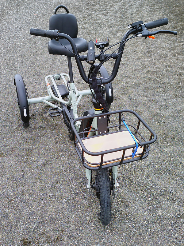

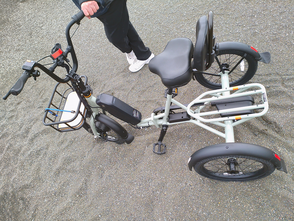

The new trike is not a 26" fat tire trike like the old one was. The old trike had an underdesigned aluminum frame, this one is steel and seems much more solidly built. The skimpy seat post strut has me a little worried. My friend is a heavyweight. This trike has the capacity to carry 350 lbs. The rear basket hasn't come in yet. Sand and more sand. Sand with dog turds and fur. It's unavoidable.
