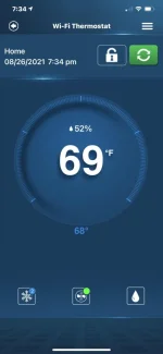

Not that you need proof but currently here it's 85F, 72% humidity, the dew point is 75F, and the RH in here is 52%. Earlier outside it was 93F and 60% humidity and RH inside was 48%.
