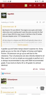

"2 grades up and hotter temps doesn't surprise me. Every grade up you run the risk of higher oil temps and higher friction. Oil pressure can go up as well due to the clearance. Your oil pressures are also directly related to oil filter used. It is not so simple as one grade is perfect so it is always recommended to stay with OEM recommended grade. If you look at charts 20 vs 30 grade it is almost identical."

Every document I have seen shows at significant difference between xW-20 and xW-30 as related to viscosity when measured at the same temperatures such as 100°C.
Using Valvoline Extended Protection as an example, 0W-20 has a Kinematic Viscosity of 8.4 @100°C versus 10.7 for 5W-30. A 24% difference, so I would not agree they are "almost identical".
