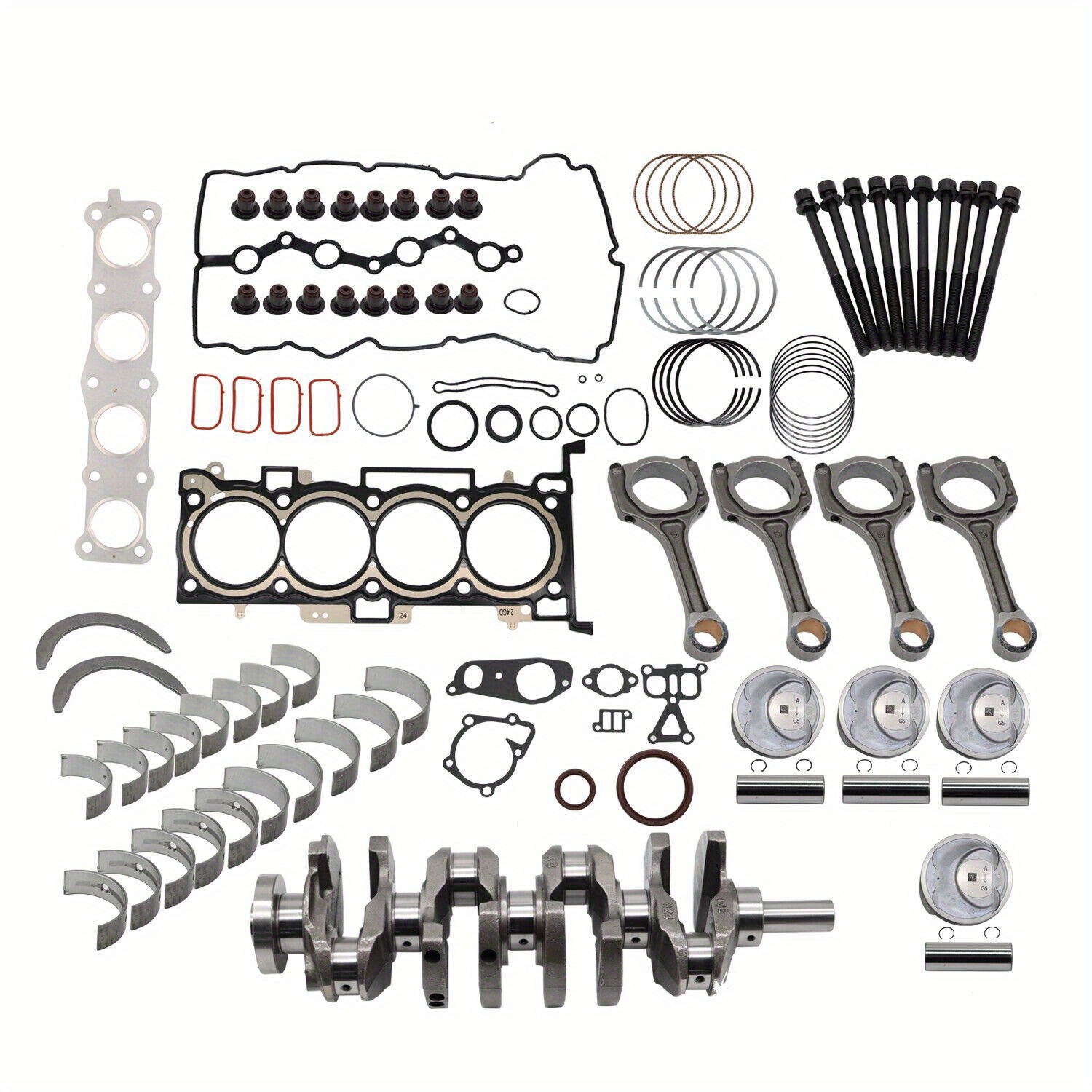

A complete short-block rebuild kit from TEMU is $222. Complete rotating assembly, everything. JBWeld the hole in the block. $1500 tops.
