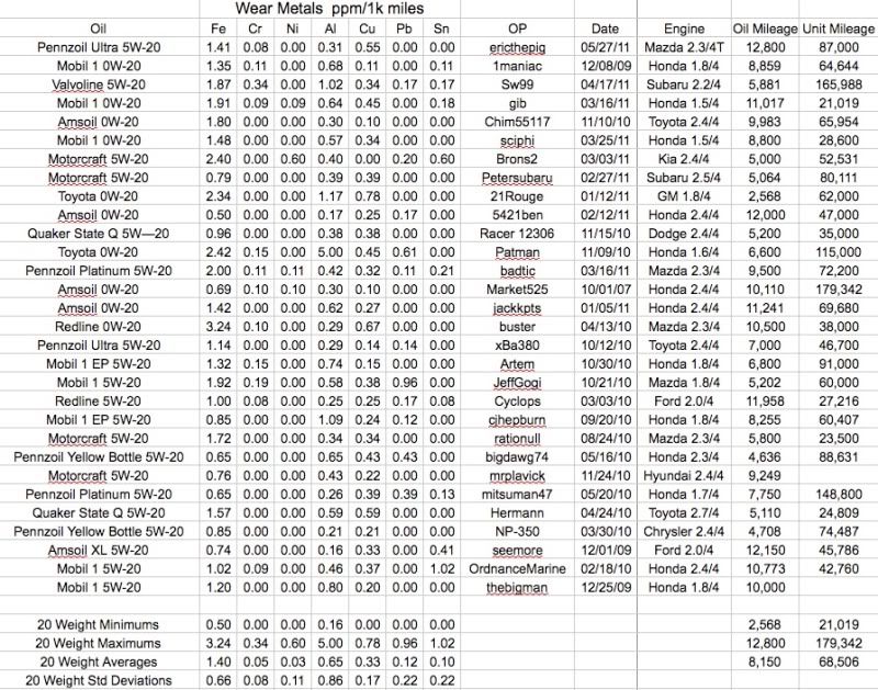

Here is the 20 weight oil data.
With this more extensive, robust analysis, it can be seen that the 20 weight oils show marginally better results for Fe, Cr, Cu, Pb, and Sn. The 30 weight oils show marginally better results for Ni and Al. That being said, neither group of oil samples is statistically different than the other. This casts doubt on the "known" superiority of 30 weight oils, at least with these 4 cylinder engines.
