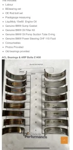

Bmw 10w60 bearing wear. maybe too viscous or constructive deficiency
Or the bottom end isn’t stiff enough and flops around like Gumby on crack playing twister… since it seems that no matter what oil or what machining is done and this is the result, I’d be more inclined to believe it’s poor design rather than an oil or bearing issue.
But then again I haven’t devoted tons of time into researching that engine’s problems…
Can you imagine what those bearings would look like if xW-20 was used during track days?
I'll bet nobody running thinner oil than the specified 10W-60 sees any better bearing wear on stock bearings while keeping all other factors constant. Also, maybe guys are using 10W where it gets pretty cold and pushing the W rating to the limit or beyond, which doesn't help engine wear during very cold start-ups.
