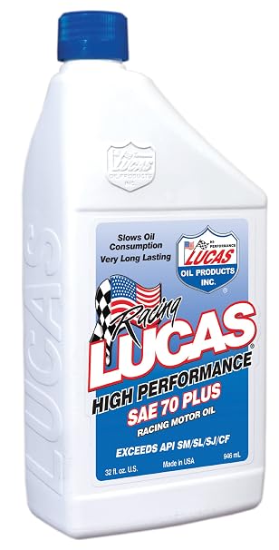

Originally Posted By: FordCapriDriver
SAE 70?? That stuff is like water !
It's not just any sae 70 it's sae 70 PLUS!
BTW if anyone is curious the Lucas sae 70 plus data sheet shows KV100 @ 30 cSt and over 5400 ppm zddp (just says zinc on data sheet though)
Zinc by weight is 0.28%!
The Lucas will fall into the upper range of SAE 140 gear oil very close to SAE 190 which is anything over 32.5 cSt @100ºC, but less than 41
The next thickest is sae 250 which is 41+ cSt @100ºC. That's as high as SAE J303 goes
