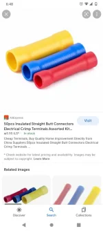

The standard butt connectors are junk. The wires can wiggle and break at the crimp. You want the ones with heat shrink as part of the connector.
