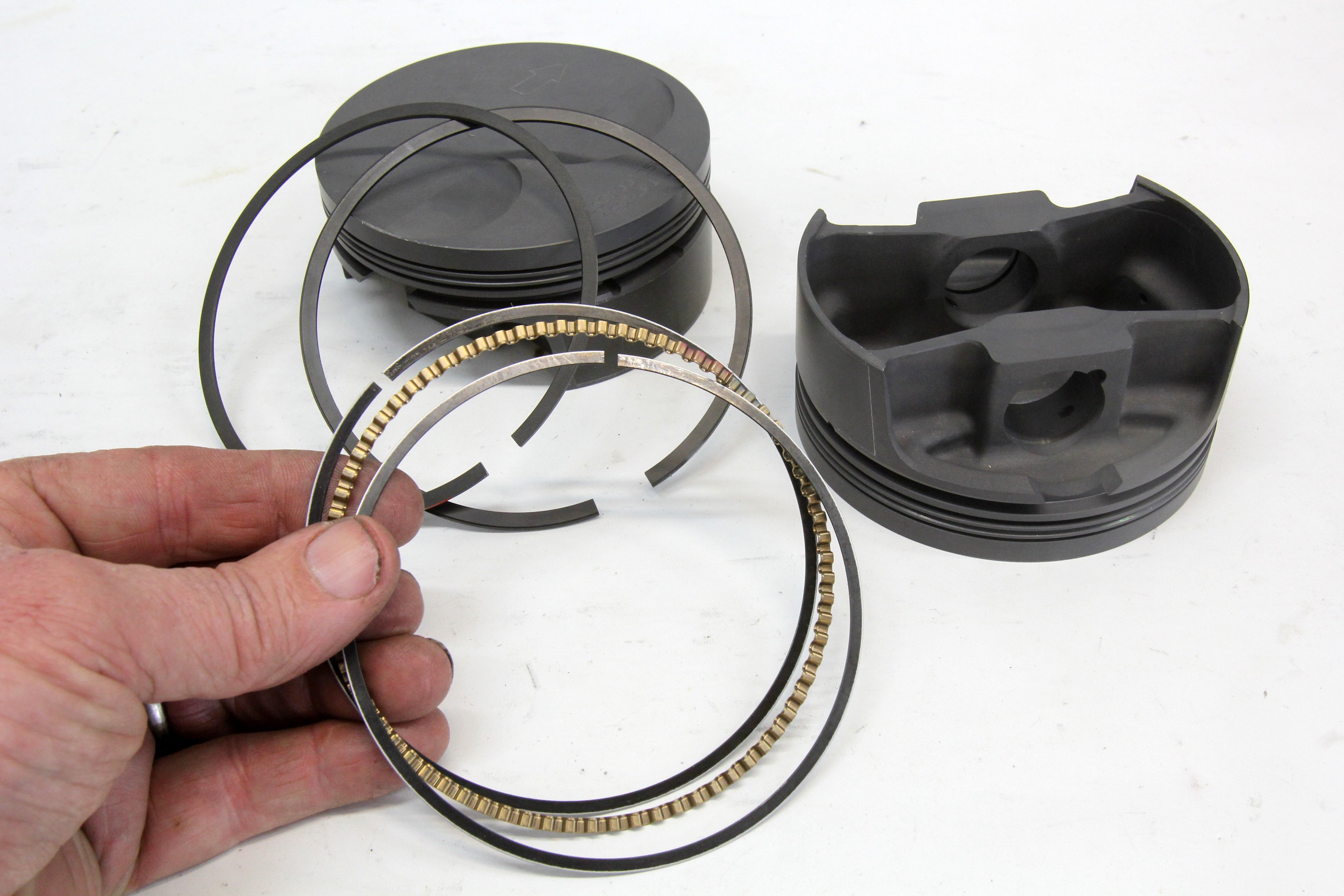

https://www.enginelabs.com/engine-t...vealing-the-secrets-of-the-oil-control-rings/
On a piston there are vents to the oil control ring from the underside of the piston. Does not matter… Splash or oil jet. Engineered that way.
Yes, that's to let oil that the scraper rings (oil control rings) collect off the walls return to the sump. Those holes plugging up due to being too small in diameter is what led to Toyota's notorious oil burner as well as the Saturn oil burners.

Negative. Plugged oil return holes, which led to the oil control rings getting packed with carbonaceous crud and then sticking in their grooves. This stopped their function: Oil control, which in turn led to copious oil burning. Saturn had the same problem.
