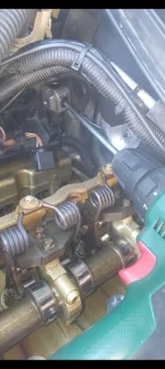

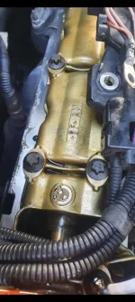

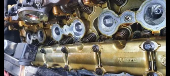

It looks like it has a lot of yellow garnish from long OCI
The oil turns yellow/goldish, the shiny part between the 2 vvt sprockets is where ive wiped it. Only some slight varnis builds op on the Valvetronic springs, all bmws have this and its not solvable with shorter ocis but wont harm the engine just like the yellowish look.
This is the same engine in a different vehicle at 120k miles.
This is what i call sludge.
Everything in those pictures are lightly yellow varnish, maybe you have better pictures
All n52 engines have the carbon build op on the valvetronic springs. Probably because the oil does not really gets on them.

That 3.5 may also hold a LOT of oil. Mine holds like 6 or 6.5 qts. BUT, does it also have a chain? Chains can be a little harder on oil. If I was going to stretch the oci much, I would use 5-30 instead of a 20 weight. I think the oem oci is 7500.
How long, or more important, how many miles will you keep it? I don't imagine any engine on 10K oil changes will be free of sludge at 200K or last to 300K.
Yeah I agree here, 5k if you want to keep it long term, why risk it for something so cheap and easy? Car Care Nut on YouTube has seen plenty of Toyota/Lexus engines start burning ridiculous amounts of oil from 10k oil changes, even when the UOA says it should have been fine.
