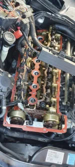

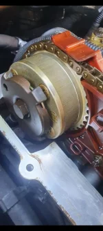

I run my bmw at 15k ocis with penzoil platnium. Now at 240k.
Engine looks like this inside.
