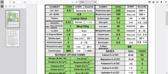

Here is the same field planted on 2018 with an Orchard grass mono culture fertilized each spring using the previous posted above soil Analysis sheet from above and here is a new one. The Orchard Grass has died off to where I and getting half the number of bales in the spring cutting. . I am debating over seeding with some kind of Brome with Annual rye grass or Festololium as a nurse crop or redoing the whole field in some kind of Brome With Rye grass/ festololium as a nurse crop. I have a brown thiumb to say the least.. I can not get a good upload of the soil test.
