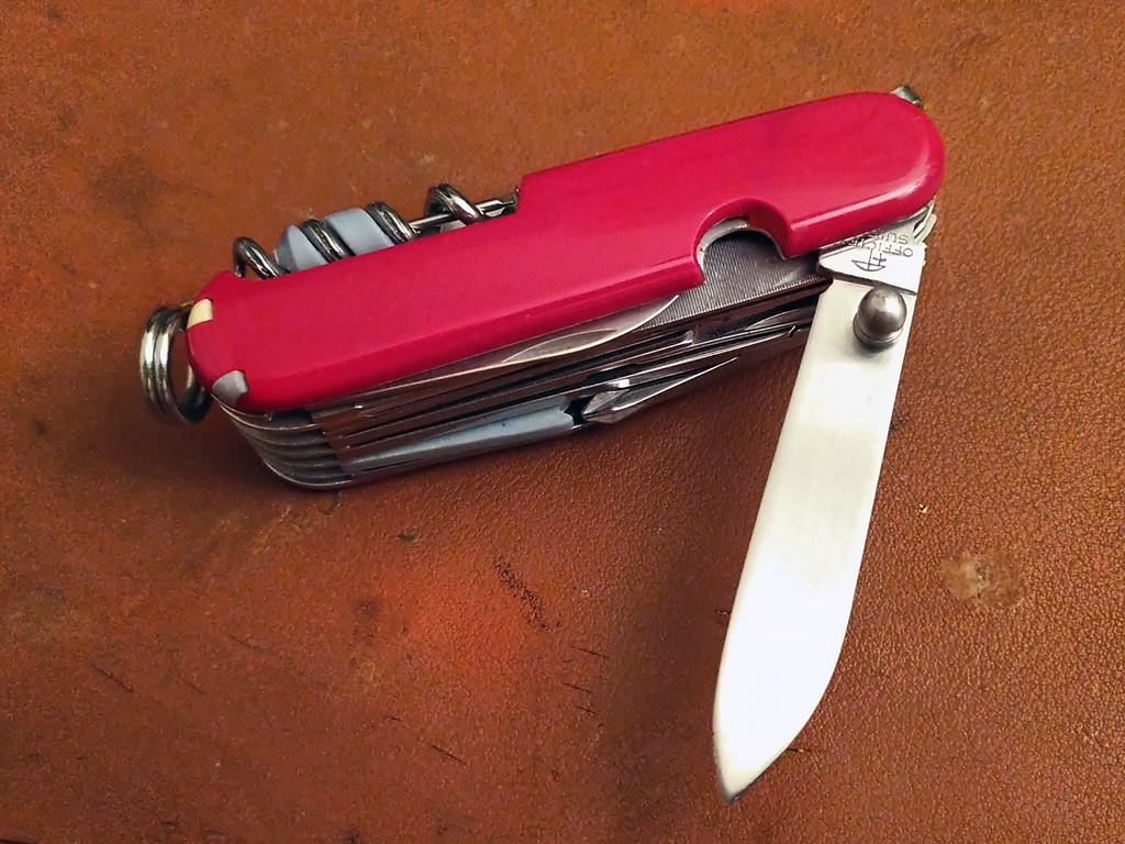

Show me your SAK mods! I'll start. I added a thumb stud to one of my Swiss Champs. I can now open the blade one-handed with my left hand. Usually, you must use a nail nick on the blade or you have to pinch the back of the blade deftly between two fingers if you want to get the blade out.

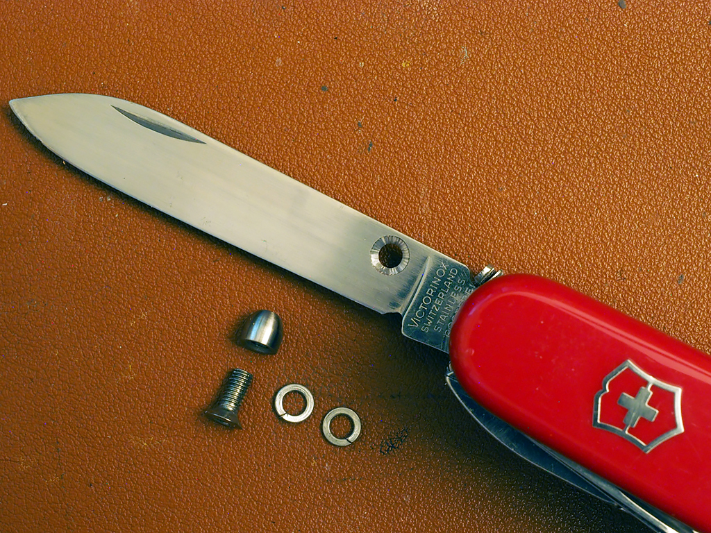

Stainless steel parts:
1x M3 bolt with a countersunk 2mm Allen head trimmed to 7mm length
2x split washer for the M3 bolt
1x cap nut, sanded down to a stud with a conical tip

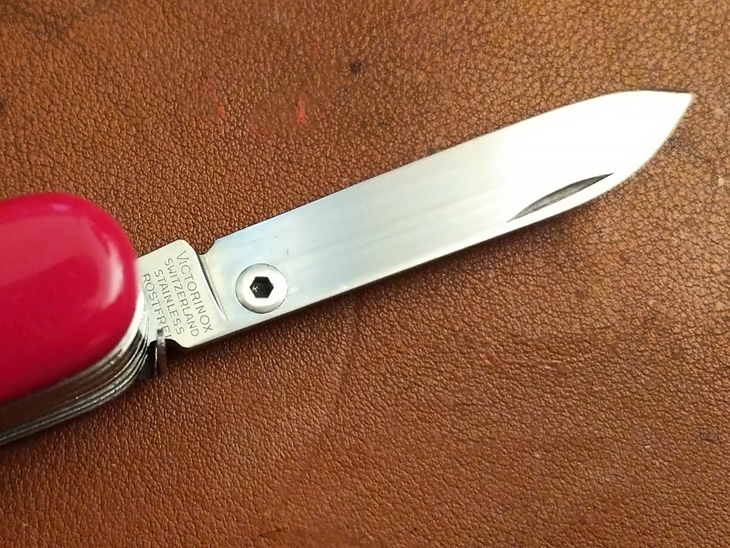

First, I marked the screw hole location with my punch and rilled a 2.5mm hole with a tungsten bit.
Next, I countersank the screw hole. You can see all the modified hardware. The screw has been cut to length but needed more trimming and the cap nut has been shaped into a stud.
Hardware installed
Countersunk head. I didn't countersink it all the way to be flush as not to weaken the blade unnecessarily.

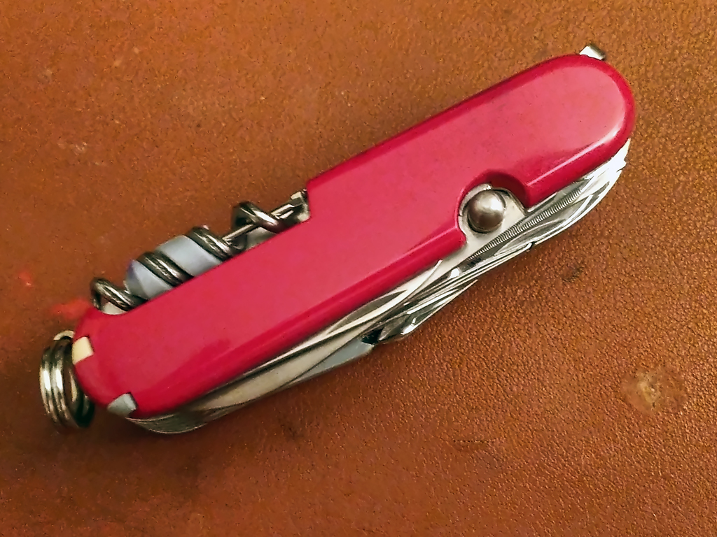

With the blade closed. You can see the area I had to cut out of the scale and underlying layer to accommodate the thumb stud.

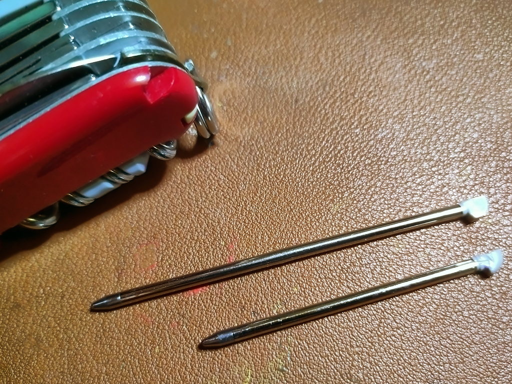

The thumb stud has not been fully tightened. I still need to degrease the parts and add some threadlocker. In this picture, you can see another modification I made. I made an extra slot in the scale for a tension wrench and a rake and you can see both tools sticking out above the main blade joint.
