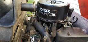

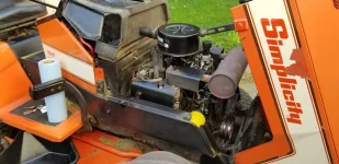

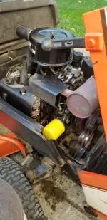

Changed oil n filter on a simplicity large garden tractor . Kohler 18 hp air cool twin. Used castrol st 30 weight. Cant use multi in these older engines. About 1.5 quart total. No hourmeter but I change at least once a year. Sometimes twice.

What kid of filter went on? Thank You

No reason at all you can't run a synthetic 30w multi-grade in a Magnum engine. The quality of multi-grade oils have improved a ton since those old owners manuals were written.
Its a stock kohler.. oem. They come in several colors. The sunstars are great tractors
My father in law loves his. The power steering is nice too.
Only issue is he doesn’t do the best at cleaning that horseshoe shaped HST cooler thing. Apparently if it gets too hot, it’ll kill the engine?
