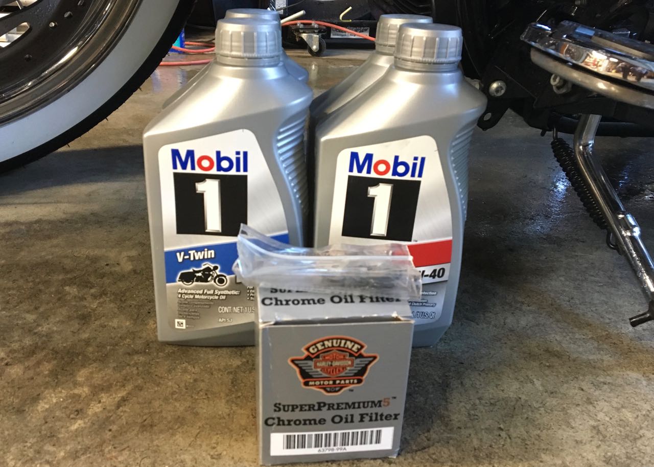

2014 Harley Davidson FLSTN 103B
Out Engine: Mobil 1 V-Twin 20/50
Primary: Mobil 1 Racing 4T 10/40
Filter: Harley Davidson Super Premium 5
In Engine: Mobil 1 V-Twin 20/50
OCI ~ 4150 ~ 24 months
[Linked Image]
