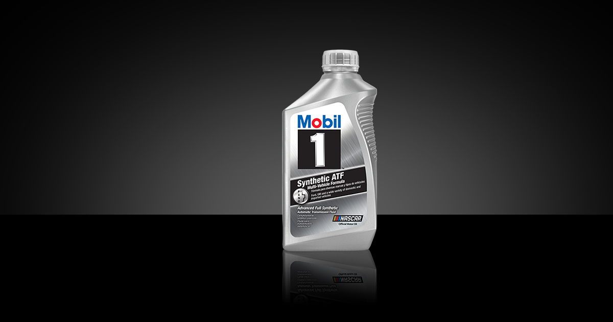

I used M1 ATF (plain-Jane Dex/Merc) in our 2002 t-case:
Performance-wise, it seemed to stay clean and actuation of the unit was quick even when extremely cold (when I'd often be putting it in 4HI).
I've also used the AMSOIL ATF, which seemed about the same.
Both are also great choices for your power steering fluid, as would really be any of the aftermarket synthetic ATF's that are D/M, depending on what you can get the best deal on.
