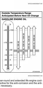

Your reply can fit well in an internet article that wants to send crude messages for the masses because they don't know better (like change your oil every 3k, or don't change at least 10k miles, or check your battery every month, or you need winter tires of you get snow) and other 1- size-fits-all statements. Reality is so much different. Every climate, driving pattern, terrain, engine design, and many other factors are so different than the next. For instant, many engines shear oil in just few hundred miles (long timing chains), which makes 40 weight oil turns to a perfectly good 30 weight oil for the reminder of the OCI. Just an example making your list useless in the grand scheme of things. You're basically painting Xw40 oil useless unless the manual swears " .. for God sake use Xw40 oil..". While %90 of engines (new or old) permits use of oils according to ambient temp.
Pic down below if from my Nissan factory service manual (notice the 20w50?)

That oil chart looks very 1980s. It reminds me the oil chart of my 1985 Toyota Corolla I used to have. That car ran anything from 0W-20 to 15W-40 with no issues. I certainly noticed significant improvement in fuel economy when going down from 10W-40 (even more so from 15W-40) to 10W-30, and 0W-20 probably made it even better. In any case now, I get 75 mpg with my 2021 Toyota Prius Prime and I laugh at the fuel-economy numbers around 30 mpg—and not to mention those of pickup trucks' and classic cars with single-digit mpgs—although you can always include another digit after the decimal point. 20W-40 and 20W-50 are still very popular grades in Mexico, as they can be made from API Group I dino base oil. You cannot find any oil made from API Group I dino base oil in the US anymore—again, that was a 1980s thing here. We need to keep up with the modern times. Every year new automation technology and new engine/motor technologies are being introduced—self-driving cars will be widespread in a matter of years. California will ban the internal-combustion engine in new cars in 2035. The UK is banning the internal-combustion engine in new cars in 2035 as well, and the rest of the Europe will do so around the same time—if not earlier. This doesn't mean that we won't still be obsessed with the engine-oil selection for our "classic cars" in 2035.
