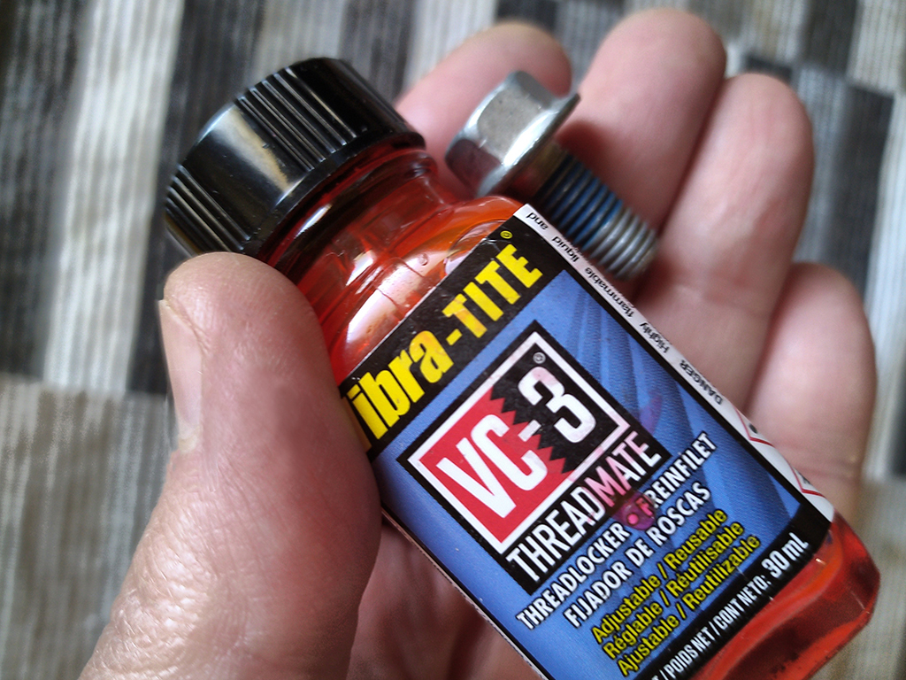

Some screws have a dab of blue or red already on them that looks like it's dry. My question is whether that's an optimum thread locker or is the better way to put the liquid on myself like I've been doing for years.
Seems like the dry version can't expand and fill the void like the liquid can but I don't really know.
Vibra-TITE is one thread locker you apply to the fastener and let it cure before assembly. It works really well. Make sure the fastener is properly degreased before applying Vibra-Tite. Automotive factory fasteners frequently come with a similar dry thread locker compound already on the fastener like the bolt with the blue stuff on it in my picture. Years ago I saw a thread locker stick that had sort of the consistency of a Crayon. You'd rub that stick over the threads. I don't remember who made that product.

The semi-solid thread locker stick is made by Fastenal. When I first found it I liked it because it made for a clean no-drip application. Then I found Vibra-Tite. In my experience, Vibra-Tite may not adhere sufficiently well to very smooth fasteners. It works fine on galvanized fasteners but not so great on stainless fasteners.
