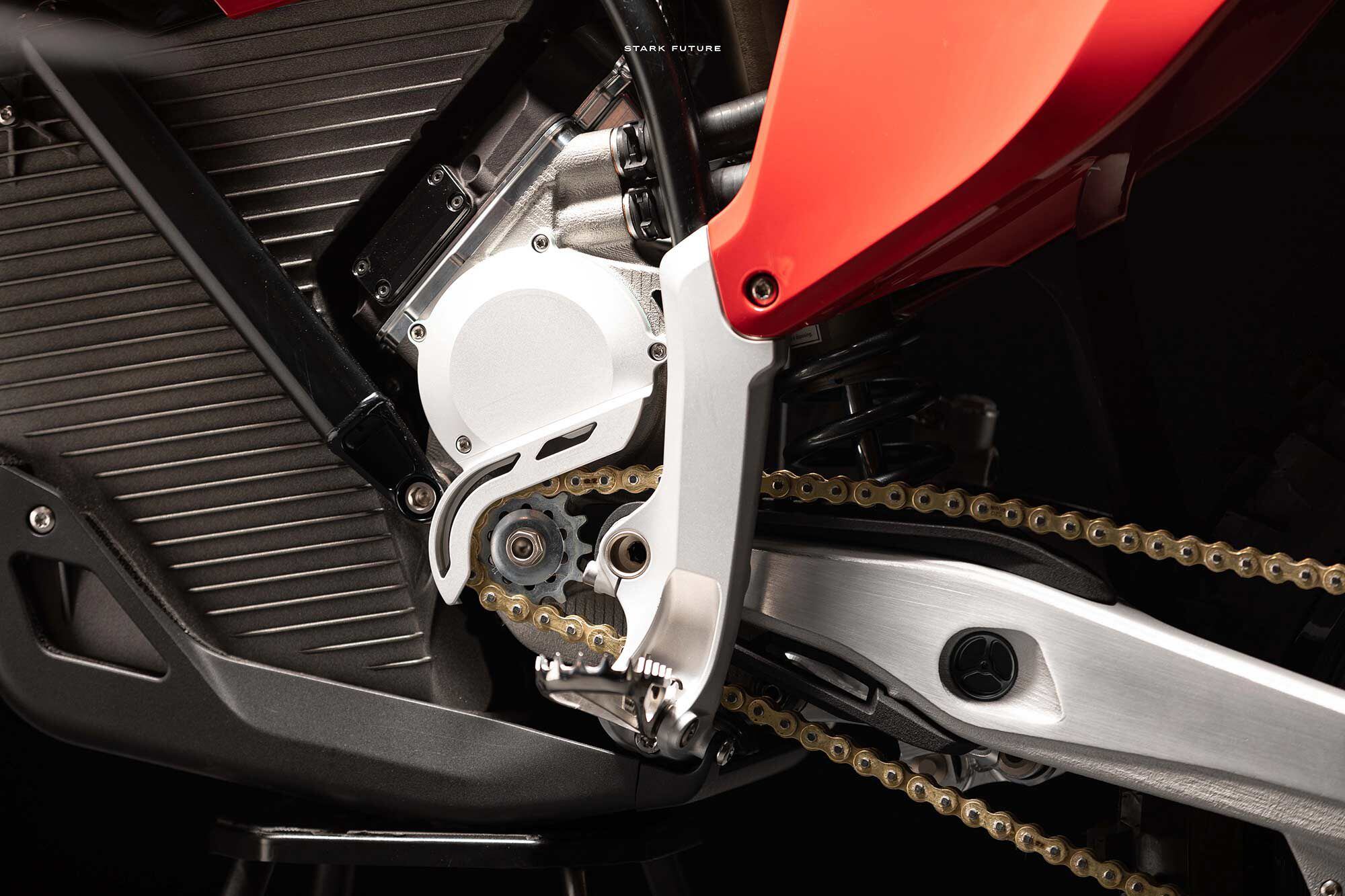

I was looking at the Stark Varg electric motocross bike the other day. The motor makes an unreal (claimed) 80HP, which is stunning for a 220 pound dirt bike. Dyno results show the RWHP to be about 66-67HP, which is still stunning. The drive motor actually makes 70 as the dyno can account for drag and that's about where it comes up. My point is, this is very high output in such a small package.
Yeah, that round thing, that's the 80, er, 70HP motor. (a little joke, still impressive as can be)
