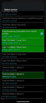

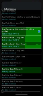

Posted is some live data screen captured too.

I would think that if it was the purge valve that you would also have an Evap trouble code of some sort, especially on a vehicle that new. I guess you will find out if it fixes it. Your fuel trims definitely show that you have quite a lean condition. plus, or minus 10% fuel trims are considered acceptable for most vehicles.
