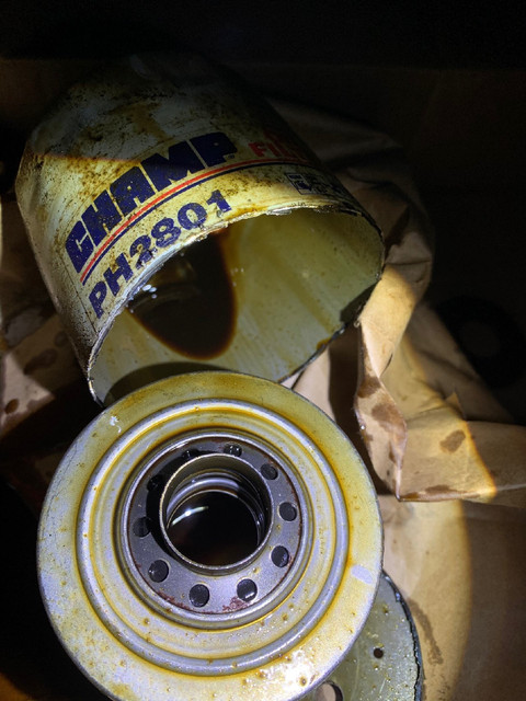

Changed the oil in my '04 Odyssey today and decided to cut open the used filter. It is a Champ brand filter, sourced from a Rockauto closeout a couple years ago. Looks to be a Champ Labs made filter-- not sure when they stopped making this style filter, but I imagine it's more than a few years old because I can't remember seeing this style in quite a while. It's the kind with 5 round holes for the inlet, where one hole is larger than the other, has coil spring bypass on the threaded end.
Ran for 6k miles using Philips Choice Shield 10w30. I've cut open plenty of unused RA closeout filters that were 10-20+ years old, and the media has always seemed fine (not brittle or compromised) despite the age. I personally don't think this is age related, but rather the extremely wide pleat spacing in that location; I've never seen one that wide. ADBV was in good condition, still very flexible.
[Linked Image from i.ibb.co]
Yep, wide pleat spacing has always been the common factor in torn media.

This is a very odd Champ filter. These Champ label generally known as jobber tier filters, yet this one uses the thread end bypass found in some M1 and Champ Labs higher tier filters. Obviously pleat spacing very poor and likely cause of tear. Seeing as this filter RA sourced and on closeout though, I be interested in seeing the date code on dome.
Topic vehicle specs 7317 application and equivalents, topic filter xref look up makes no mention of 7317. Entered in Fram look up, direct xref is to PH2921 with applications being OPE, Cat. and some very old vehicles. Not sure how RA arrived at topic filter for Honda Odyssey, but I wouldn't have run it on one if mine.

That's technically a "collapse" failure. If the media tears and/or if the center column buckles, it's a collapse.
Primary failure mode is poor pleat spacing. Media is really "springy" once it's baked. Sometimes it doesn't like to cooperate.
Secondary failure - looking at the pics. The check valve is LITERALLY right in front of the bypass valve. Get that oil up to operating temp, and that rubber is nice & pliable, meaning those little "feet" on the back of the check valve would not have much rigidity to prevent the CV from blanketing the PRV holes. Partially or fully-blocked PRV could result in spike in pressure delta across the filter which could result in a "collapse" event.
As noted, OP thread end bypass a long time Champ Labs design used on their upper tier filters. That includes some Mobil 1 and even in the factory FoMoCo filter when Champ Labs made them, as posted this subforum. Excepting silicone adbv in FoMoCo and Mobil 1 filters, identical design. My take, zero wrong with the Champ Labs thread end bypass design in OP.
As mentioned previously several posts, very poor pleat spacing uniformity the most obvious and likely cause. Specifically the wide pleat spacing area where vast majority post use anecdote tears from all brands seen.
No way to tell for sure, but even if those standoff feet on the back side of the ADBV collapsed some, there's no way the back side of the ADBV could lay perfectly flat over all the holes on the bypass valve and seal it off.
There was an M1 cut that had at lest as wide pleats in the usual area. Bad manufacturing probably along with old media in this case. I bought a whole case of highly regarded filters from RA and used one. I had to take it off because the start up knocking even when oil warm was terrible. Never buy old stock again. These were the old blue Denso btw beautifully made filters. Past their useful life. Never had that happen in my life, lesson learned don't be cheap on oil filters.
I'm in with Zee, your theory is fake news. The feet plus the design of the ADBV prevent this. Remember that once the engine is running, both sides of the ADBV are at essentially the same pressure so PSID=~0, and the amount of flow will determine how much the ADBV is "lifted" from the inlet holes. Since overall filter flow is limited by the exit diameter, and no normal engine can pump more oil than this hole can handle, you're never going to be able to generate the kind of force needed to collapse the ADBV backwards, let alone seal it off completely long enough to block flow. My interpretation may not be entirely correct with respect to physics, but its surely closer than the idea that the ADBV can block the PRV. Don't you think that's been tested, since this design is used by multiple filter manufacturers?

I prefer to call it false/inaccurate information posted about the Champ Labs thread end design. Although as I read it, my conclusion was more along the lines of, 'when you can't dazzle them with brilliance, baffle them with bovine excrement.' There's nothing wrong with the long time Champ Labs thread end bypass design.
Linked is site showing identical Champ Labs thread end bypass design on higher tier M1 and K&N, scroll. If further interested, google bitog site and insert FoMoCo Ford Focus Factory Filter, see identical design. As noted I'm surprised topic lower filter didn't use more common Champ blue button dome bypass, but I suspect filter age could be a factor.
Fake news my foot! It's simply a theory, guys. Sheesh -- lighten up!
Sure there are feet on that check valve, but rubber gets nice and pliable at 300degF. And those PRV ports will get awfully thirsty.
Don't need "force" to collapse a filter. Just need a little water in the oil sump and BAM your media is completely compromised, and oil is looking for the next path of least resistance. Running at a higher differential in bypass-mode, a weak spot in the media (that flat pleat) could be exploited. Certainly plausible with everything I know about filtration paper.
