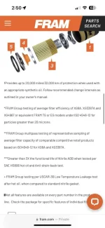

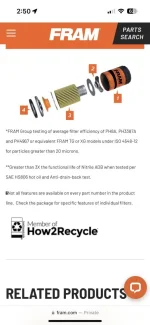

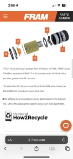

I believe most oil filters are. Even Fram says 95% for particles over 20 microns. People don’t seem to read that part

Yeah, I'm not following where you're going with this either... All your screenshots are showing is that they're reported at 20 microns. Fram is very transparent about which 3 filters they averaged to get those numbers.
Ultra says 99%+
TG says 99%
EG says 95%
