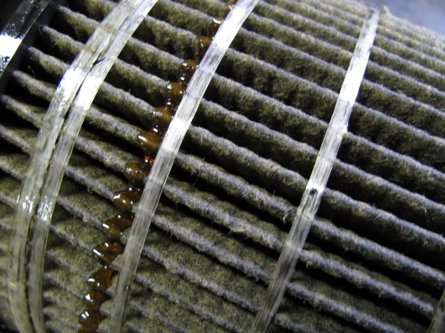

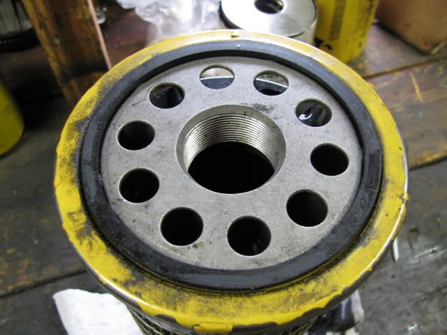

engine oil,, High efficiency very well built heavy duty filter flows 80GPM, CAT says this is a 500 hr filter i believe it,trying to find out the efficiency rating on this,working on it.
Large inlet holes

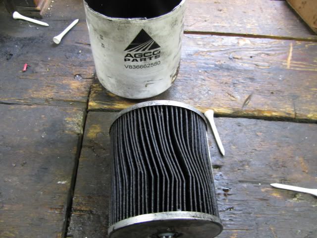

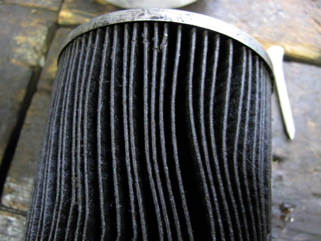

love the banding that holds the media uniformed

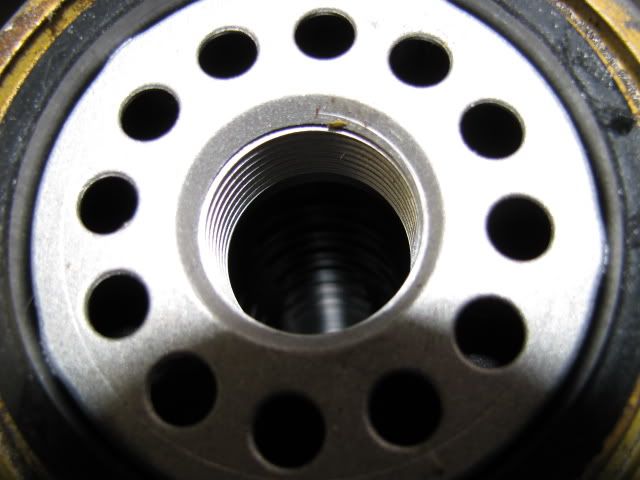

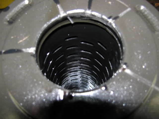

center tube shot...escraps should follow this design

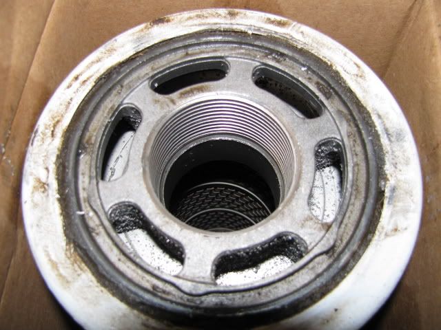

Primary fuel same design as the above oil ...

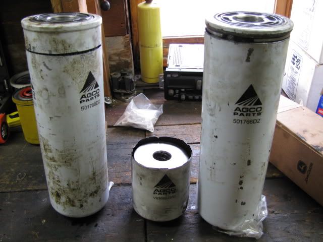

Primary hydraulics and transmission,both apps take the same filter 15 or 20 micron i beleive...

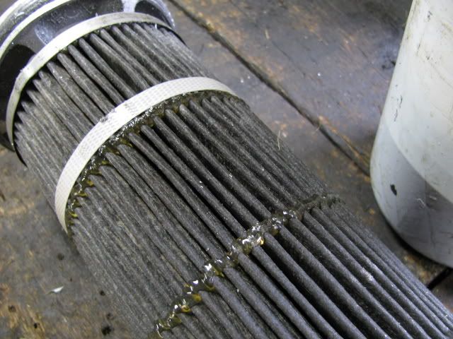

and thrown in a engine oil from our smaller 185 hp Challenger 635B

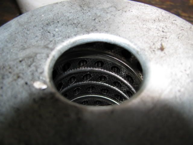

center tube...

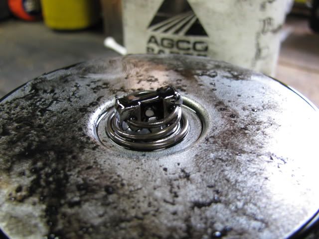

By pass....

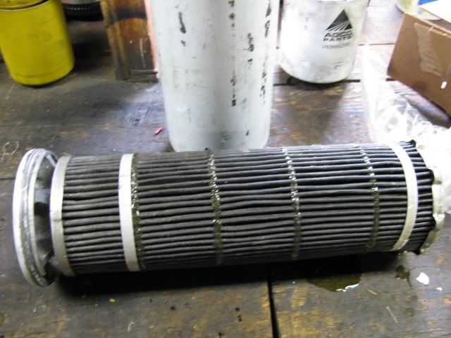

upon inspection the filterers showed no abnormal signs of wear or larger particles, a complete filter change is around $300.
