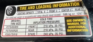

The payload on half-tons still have a tendency to be around 1,500 pounds. While manufacturers tout 10,000 to 12,000 towing capacities, the reality in most situations is half that due to payload. I would agree after reading the Motor Trend article on a 5,000 miles-mostly off -road trip with several Rivians they are a nice truck/SUV. I would be curious what the yellow and white sticker in door jam says about payload on your Escalade.
1297 lbs on mine. It has optional 20" wheels. So if you put 500lbs of people and gear in you might only have 800lbs for tongue weight making that 8100 rating a bit lofty. but towing 5k with 8.1k rating would be good.
