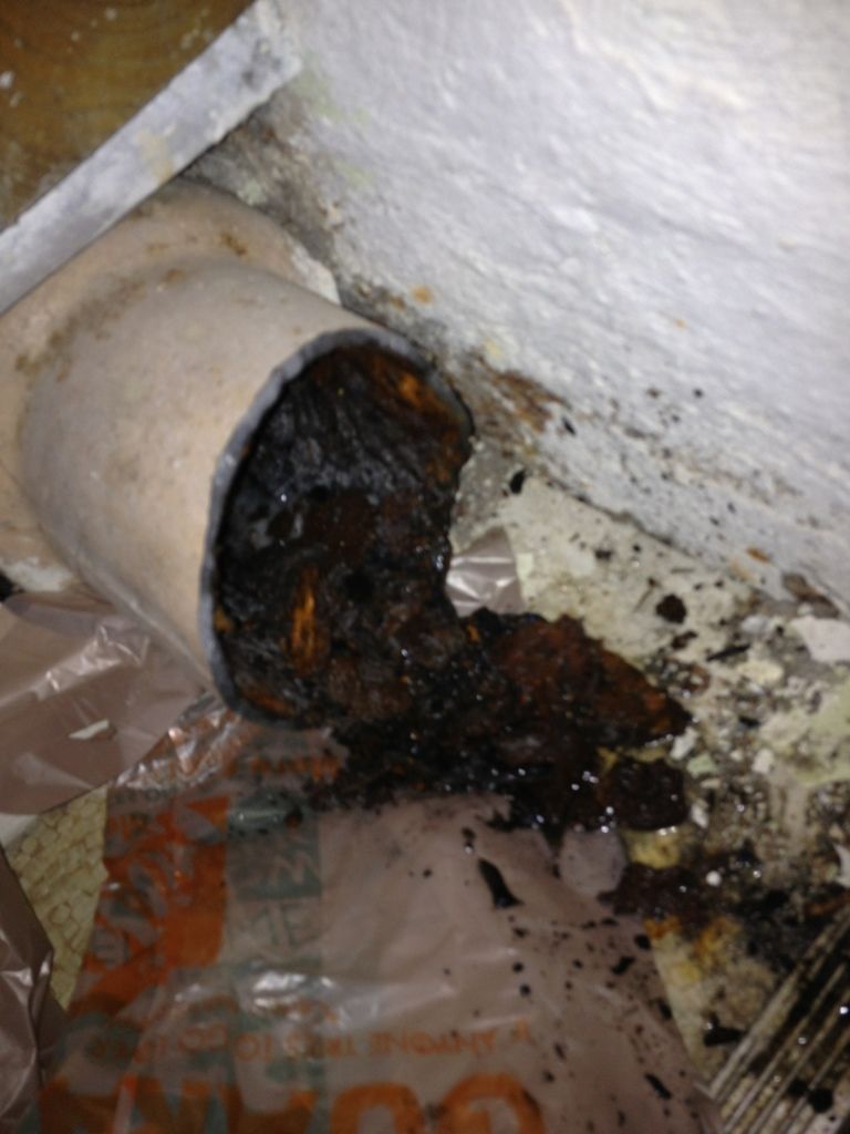

So it all started with this leaking water that showed up as a puddle on the basement floor, after taking a long and tortuous path. Yuck.
Knew about these for a while, but they were getting worse.
After reading here:
http://www.oldhouseweb.com/how-to-advice/cast-iron-waste-pipes.shtml
It appears I had both telltale failure types. The vertical risers looked perfect and were both at the far end, and the horizontal part going into e ground also looked perfect. Turned out they were.
So we took to removing the old pipe. Tried our had with the chain cutter in an area where the pipe was porous like the second picture of bad pipe above, and it imploded. Used it more like a tubing cutter on a section where I needed a butt joint, but didnt want to chance it (didnt snap despite a lot of force), so finished it off with a sawzall with diamond blade. The metal looked good.

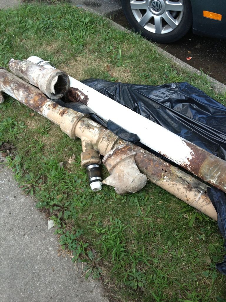

Had used the chain cutter and a sledge to break the rest.
A well placed blow caused a fracture along the bottom of one section of pipe.
Turned out that while the top was nice:
The bottom had eroded very thin, this the rust stalactites.
Apparently the pipe was made in Salem, NJ. Likely Salen Brass and Iron Foundry, per thism1916 ad on using cast vs wrought sanitary pipe.

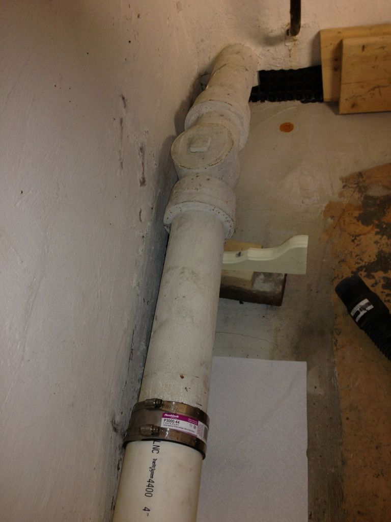

So then we went to put the pipe in. All 4" PVC with no hub couplers on both ends. The other end opposite what I showed above was already cut from an older patch.
Cemented it all up... Added a clean out in a convenient spot, only laundry standpipe (new) and laundry sink are beyond it, and technically there is still an iron one forward of it at the very end.
Connection to old porcelain laundry sink:
And new standpipe just path it for laundry
Torqued the no hub couplings to 60 in-lb, and all has been well, knock on wood, so far at both ends.
