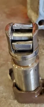

A dealer tech posted on here in the past and indicated that the cause of failure is poor surface hardening in the pin or roller. The needle bearings begin to produce a small groove in either the centre pin, or the roller. This creates a spot where it can "stick", and this eventually gets larger and larger until it completely stops rolling, at which point the lobe gets wiped-out in short order, as does the roller.
I mentioned that before, not sure if you meant me. Anyway, here is a pic....look close and u can see the pin is worn. It is NOT a roller problem, as in the little rollers....Once pin gets worn enough, with enough clearance, the small rollers jam/pile up, and the outside roller stops turning....game over fast. The marks u see on cam are just crappy surface hardening/treatment they use. Have seen that for years going back all the way to 88 or so on 2.2/2.5.....used to see it on them, on the roller cams. See it on other manu. also. They will go quite a while like that, but that said personally I wouldnt reuse it. And the 3.6 tick issue is the same thing, soft pin. Oil will NOT fix any of this.
Yup, pretty sure it was you ;) Thanks for chiming in!
