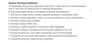

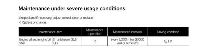

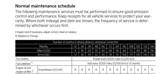

I’d follow the severe maintenance schedule if it was mine.
