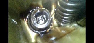

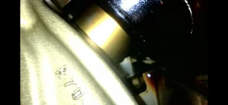

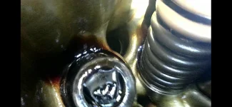

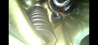

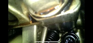

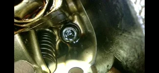

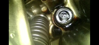

Here are photos inside the front valve cover area I took today with a borescope, went in through the fill port. The oil has about 1000 miles on it now. Hopefully you can recognize some things inside - valve springs, rocker arms, cam shaft.

This will make the 3k mile changers run for the hills but the proof, on this machine at least, speaks for itself. Looks very clean as I hoped it would from running HM oil in a warm southern enviornment. Was the 0w-20 Mobil HM the 10k version? Semi-Synthetic or?
Also, The pic I've attached appears to have really scuffed cam lobe but I'm assuming, & hoping, that it's just bad reflections from the scope cam.

Thank you for uploading the photos. I am happy that your engine is internally clean from what we can see in the photos.
