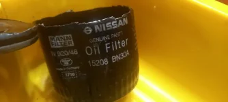

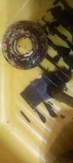

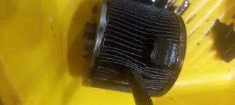

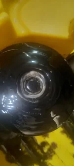

Well knock me over with a feather.... other than the filter material being a bit brittle, it was not what I expected. I think dear ol dad's memory isn't what it was. I think he did have it serviced and had forgotten! Long distance trips for the most part. The new oil still looks soot loaded, although clearly much slicker to the feel.
Stout filter by the looks..

On most diesel engines the oil is black in a very short time. I know my 2012 Ram Cummins does this regardless of OCI. It’s how diesel’s work. The fact that the funnel was coated is good IMO. That means the oil was “sticking” to the funnel. You want your oil to coat things, especially items like bearings and cams etc… Color on a diesel doesn’t mean much IMO.
FWIW I change the oil and filter and go whatever OCI you intend to run.
Just my $0.02
