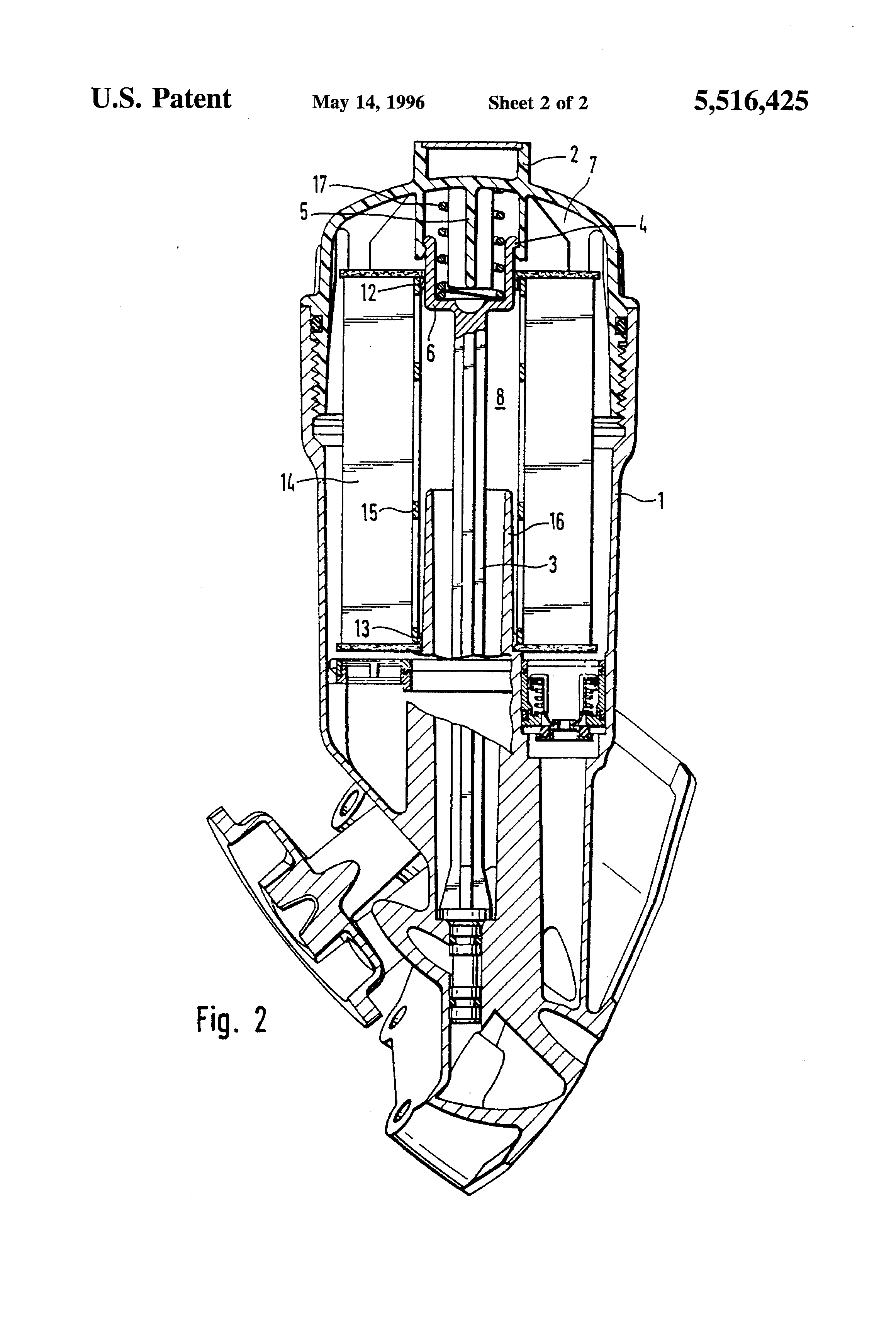

Originally Posted By: Trav
Going by memory of the earlier MB filters this ADBV does not function quite like those found in a spin on filter. Its only job is to prevent oil flowing back down into the pan, it doesn't open and close in use and is not part of any sort of bypass valve.
On the earlier one there was a support in the center with an o ring on the bottom, you removed it along with the cap and the filter housing drained otherwise you would pull the filter and a litre of oil with it (old diesels), a new lower o ring and upper cover o ring were installed and that's it.
Now they did away with the support tube and put the drain on the filter itself instead of the center tube, without it the engine will not build up enough oil pressure to prevent damage but enough to activate the pressure switch and a major portion of the oil is now going right back into the pan before it goes through the system.
It has the same effect as leaving a galley plug out when doing a rebuilt. This is how I remember them working.
Thank you, Trav. Yes, I located the patent of a similar design and it's not an anti-drain-back valve (ADBV). It's a plug that opens when you remove the cap or oil filter so that any oil in the housing drains into the oil pan. In other words the hole in this plug opens into a passageway to the oil pan. It remains closed at all times except when the cap/oil filter is removed. Note that most oil-filter housings seem to be facing upward these days and there is no chance of oil spilling onto the ground from the housing. It's for removing the dirty oil in the housing, not to prevent a messy oil spill.
As you said given the size of the plug and hole in this case, it's unlikely that the oil pump can provide enough oil flow and/or pressure through the system if it's left unplugged, as a lot of oil would flow back into the oil pan from the open hole.
The third-party TSB posted here that made the claim that this plastic extension actually pushes a valve open is wrong. It's the opposite with it closing an otherwise-open hole.
In my opinion this is an overengineered bad design. MB should have kept the plug attached to the cap instead of the oil filter if they wanted a housing drain hole like this.
Yes, the shop is at fault and the owner should have done a better research as well. I hope there wasn't serious engine damage.
Mahle GmbH patent US 5516425 A
I would like to see them go back to the old style cap with two nuts on top and the metal center. There is no doubt in my mind the engine is hosed if it was driven or ran for any amount of time.
The bottom end and etched cylinders are the most likely damaged parts due to oil starvation but depending on how long it ran any and all lubricated parts may be damaged. New engine time, its probably cheaper than sleeving and rebuilding the old one.
The drain valve cap got moved to the filter to assure that the o-ring gets changed at every filter change. Even if you supply the o-ring with the filter for the old design, you can't be sure every mechanic will change them. I've seen some pretty horrid looking o-rings on the hyundai diesels I service.
