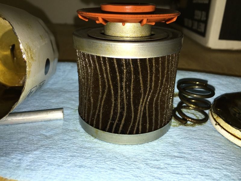

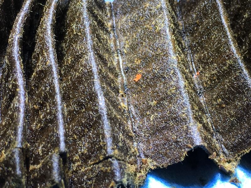

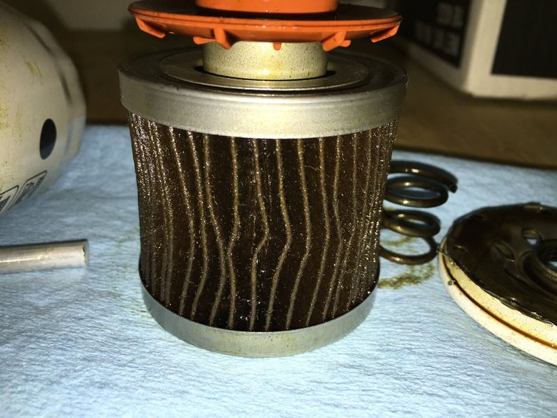

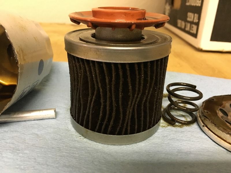

This came off my 07 RAV4 with 83k on the engine. The filter was on for 5k (1 year), using Havoline DS 5w20 syn. This OCI I used my $2 per qt Castrol Gold EP 5w20 syn and a Napa Platinum filter. I know the Castrol is overkill for the limited miles I go on this vehicle, but whatever it was cheap so why not use it. I normally use conventional. The filter was a little more wavy than I expected for 5k, so I cut out the media and held up to a bright back light and fortunately had no tears or holes at all, Also didn't have much grit in the can even though the oil was darker than I expected for 5k, must be doing some cleaning from earlier in it's life when I wasn't as on top of the maintenance as I am these days. One odd thing though, it had more than a few small red flakes caught by the media, see pic. These are really small, most look like maybe a quarter to half of a mm, the largest of which I took the pic of. Any idea what that is? I vaguely recall someone else on here asking a similar question but can't remember for sure. Also, does anyone else think that flake looks like a Canadian maple leaf???????

Red flakes might be some kind of gasket material used in the engine.

Yeah, a little wavy for me too. I use a lot of these filters too. Three in forklifts and one in a Camry Hybrid.

Was there a lot of short trips on this one? I don't think of AZ when I think of a damp area, but maybe some moisture in the oil? Looks good otherwise, though.

Yes a lot of short trips, probably 50% of the miles are short trip, which is why I went ahead and changed the oil even though there was only 5k on the Havoline syn, I didn't want to go past a 1 yr interval. However even with the short trips the engine gets up to temp quick in all but the coldest temps around here (which last like 3 weeks at most), plus the car is garage kept so it never gets below 55 degrees in there even if we have a cold snap. I'm guessing the oil is up to temp in less than 5 mins or 2-3 miles. For a good chunk of the year it takes almost no time for it to get up to temp. I've moved to syn filters in pretty much everything mainly because I'm a long interval kind of guy for both oil and filters, so maybe the sturdiness of a syn filter will be helpful in this case. I plan on leaving the Platinum in there for at least a couple OCI. Would it make sense that maybe the oil is doing a lot of cleaning and maybe the filter is more loaded than it appears which caused the extra waviness? The last filter I used was an OEM Toyota YZZF1 and it came out with zero waviness.
