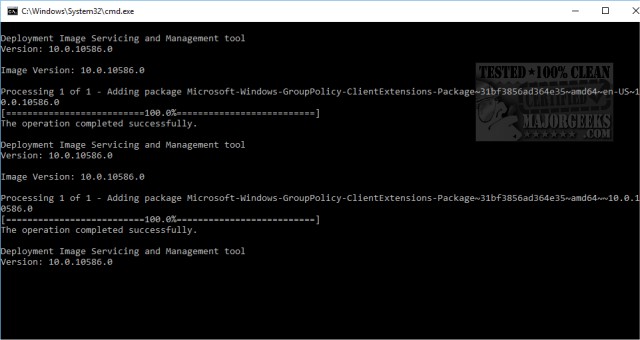

Home versions may not have gpedit but it can be downloaded.
https://www.majorgeeks.com/files/details/group_policy_editor_for_windows_10_home_edition.html
