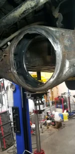

Is that a crack in the red circle?The breather tube was replaced and is dry. This is coming out around the upper connector attachment.
I think that is where the clamp thing is attached and coming off.
Jb weld IS a permanent repairHow bad is the rust on the rest of the housing? Depending on how long you plan on keeping the vehicle, I'd be tempted to wire brush that area, clean it and coat it with some JB -Weld for the time being. Not being under any pressure it should take care of the leak while you decide on a permanent repair.
Since that's well above the normal fluid level, it's not going to be a significant leak. It's 20 year old truck. Live with it.
If it's just cracked at the base of the vent assembly, clean it up well and put some J-B Weld or similar around that area.Since that's well above the normal fluid level, it's not going to be a significant leak. It's 20 year old truck. Live with it.
You know I can't do that....Since that's well above the normal fluid level, it's not going to be a significant leak. It's 20 year old truck. Live with it.
It's not at the base of the vent assembly.If it's just cracked at the base of the vent assembly, clean it up well and put some J-B Weld or similar around that area.
Where is it? ... seems like it's up high by the vent from your photo.It's not at the base of the vent assembly.
Up high. The vent is towards the drivers side. This hole is in the top middle.Where is it? ... seems like it's up high by the vent from your photo.
