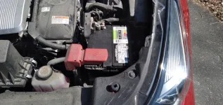

I'd go with the $60 26R Value battery. That's all a 4.3 engine needs.
This is the 26R I put in my wife's prius to replace its factory 140R/H4. A proper replacement starts at $180; this was $60. Same width & length, maybe a little taller. Way more reserve capacity and CCA. Not sure why Toyota puts such a bizzarely terrible yet expensive size in an economy car.
