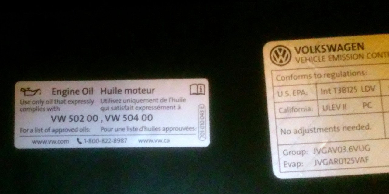

I agree, again I'm not defending his choice. I ran non-508 in my passat a couple times and know it was completely out of spec. I even posted a uoa of the MC used and we discussed it. But 504 would have been out of spec too. I don't think VW considers "degrees" of inappropriateness, just appropriate and inappropriate.

VW considers 502 and 504 interchangeable protection wise because of HTHS. Obviously 504 is much newer, cleaner running spec due to changes in gas, GDI etc. Other than HTHS VW 504 is very similar to VW 508, which is why it is often recommended instead of 508 since the 0w20 is all about CAFE anyway.
But VW is always playing games with oil as edyvw often points out. For example, the Atlas of the same year as my Passat, exact same engine, only has VW 504 sticker while above my identical engine/year has 502/504. And manual says something else confusing.
