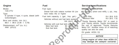

In my owners manual, 0w30 or 5w30 are the only acceptable viscocities, and it must be ACEA C2.

in so many words they’re saying don’t **** around and buy TGMO C2. they want the maximum possible ESP and fuel economy in your market
in the middle east where they come fully deleted you can use whatever you want
