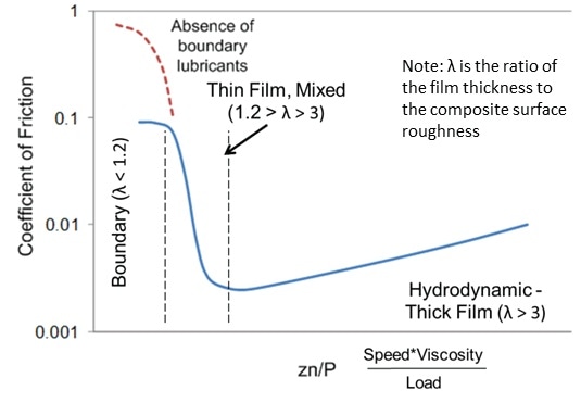

The goal is to keep the following value about the same for the higher-force (torque) tunes:
.... Keeping this constant: ---> speed x viscosity / load , where "speed" is RPM engine rev, viscosity is how thick the oil is, and load is related to BMEP or engine torque.
If you increase viscosity it keeps the "visc/load" part constant. Higher loads are countered by higher viscosity,
Another factor is higher piston heat in performance tunes, which creates more localized heat around the rings, regardless of oil cooler which is located elsewhere on the engine.
[Linked Image]
Do you think while commuting the cars rev are going to be so high to be in the boundary zone?.
If the OP had told us he use the car in tracks days every single weekend I would advice him to use the 5w40
