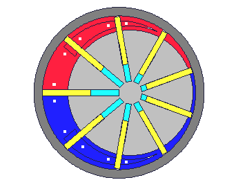

and the low pressure pump could be this type, I have a stand alone oil pump designed to suck oil from the sump using this. There's quite a bit of moving parts
