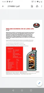

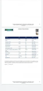

Will put in some documents with the specs for all oils and filters.

Think i will give the Midland oil a go as it's just under the 0W30 oil standard with a HTHS of 2.8.
Its also the one that provides the Subaru OEM oils in Sweden.
