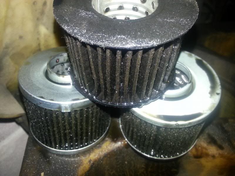

That 3-cyl 16hp should be a d600 or a d662...they also make d722,d782 and d902 in that line called "super minis"...awesome little engines imho...I have a fleet of 13 rental pressure washers with the d902 engine and have sold 50-60 of them over the last 3 years and they all come oem with the small filter although they have the 20 x 1.5 thread instead of the 3/4-16 that yours has..mine all have the little filters and some of them are nearing 3000 hours with nothing more than a 200 hour oil/filter change with 15w40 conventional diesel oil..no issues....i think the metric thread was an accross the board update quite a few years ago...i also have some d600s and d722s out of big lawnmowers that i got off ebay that all have the metric thread.....personally i wouldnt worry about the big filter unless you wanted to do it for peace of mind...it cant hurt...help ?..who knows.
here are some pics of the filters i use...left-oem comes on engine.....center kubota hh150-32430 oem replacement...right mileguard/fram orange can ph3614 that we use on our engines...$2.50 vs almost $12 for oem.
