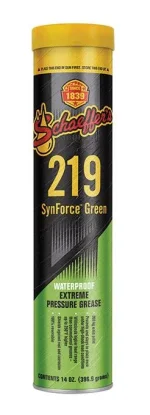

Thanks to glowing reviews from other members here I’ve switched to using Schaeffer’s #219 Synforce Green as an all purpose grease at home and for everything at work with good results. Everything from the lawn mower and loader tractor to electric motors and bearings on augers conveyors. Again, congrats and good luck with the new tractor!

I am using 238 for the front end loader and 219 for the tie rods and most other fittings, no issues on the BX2680.
The 219 uses a synthesized moly that can be used in applications that usually recommend no moly like some needle bearings.
When switching grease types it is a good idea to flush the old grease out of the joints simply by filling it until the grease coming out around the boot or joint is the same as going in.

I too am confused about the no-Moly part. Those are two applications where I’d think a 3% would be ideal. If you are dead set on following the manual then Schaeffer 219 would be my pick. I use it in almost everything.
