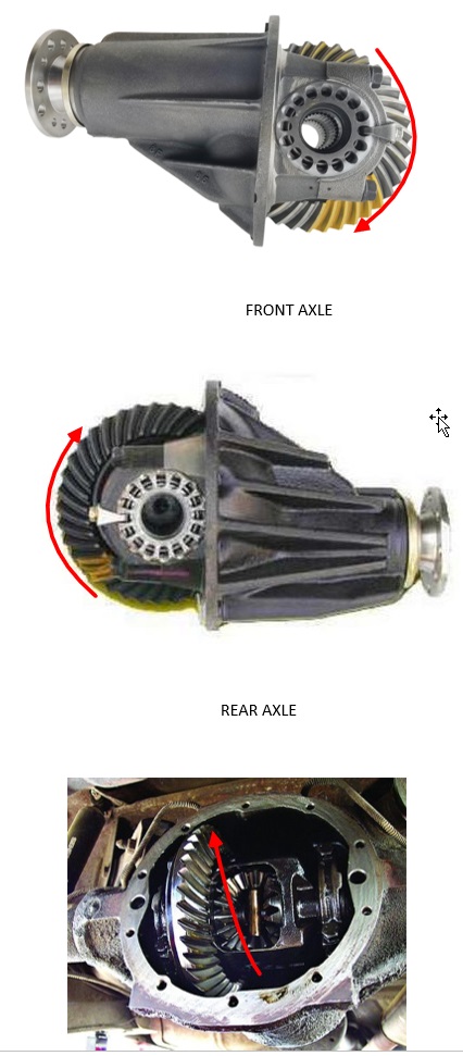

I have a couple of Metal Cloak axle covers that I will be drilling and tapping for a temperature probe soon. The rear axle I have fully figured out and know where to install the probe for a good temperature reading while the axle is in operation.
Note: these photos are for representation purposes only (these not my axles, though I do have a high pinion in the front and low pinion in the rear as shown).
Taking into account the ring gear rotation direction of the rear axle, the arrow on the bottom photo is typically the path the oil takes from the bottom of the housing and over the top of the ring gear. The temperature sensor is located in the axle cover about where the end of the red arrow ends and the temperature reading is steady while the axle is in motion.
The front axle is where I am scratching my head a little. Part of the problem is there is a front axle disconnect which prevents the ring gear and driveshaft from spinning while in 4x2 mode. I have not been able to get out and into 4x4 mode for any length of time since C19 hit. The few times that I have been in 4x4, the temperature gauge seems to read, but I want to be sure that where I have the sensor located (same place as the rear) is optimum.
My question is this—does the oil in the front axle follow the same path (but in reverse) as the rear axle? In other words, I am assuming the oil goes under the ring gear and under the bottom of the pinion gear, but is there enough that carries over to splash consistently on the upper part of the axle cover?
I searched for a front axle YT video that had a clear cover, but could not find one.
Thanks in advance for any insight.

ACE - I am just looking to monitor the average temperature of the fluid and not to dive too deep into the various areas of temperature difference (ring gear versus pinion versus bearings). I found a number of clear cover videos of the rear axle and thus my choice for its sensor location. The area is constantly covered in fluid while the axle is turning and is a good spot.
I am less sure for the front since the oil is first directed under the pinion gear. I am trying to keep the sensors fairly high on the cover so that I do not have to work about an off-road obstacle hitting them. The front is the most vulnerable since it is going head on into everything. I may fabricate an skid plate extension to add to the axle cover skid plate to further protect it.
I am just trying to understand if the upper part of the front cover is also bathed in oil as the rear one is.
PS... I have sensors in the OEM covers now and the rear works just fine. I could probably go in 4x4 off-road for about 5 miles and I would know if the front is also in a good spot.

Is this is the same axle from back in May? Gear oil flies everywhere in the diff, thrown by the ring gear and the carrier.
You're going to pick up the heat of the oil, carrier, and air inside the diff. I don't think it will be too far off wherever you place it.

There really isn't a sump as the oil is constantly churning and thrown everywhere. A 1 1/2" probe in a Jeep axle is definitely going to be hit by hot oil.
Is this is the same axle from back in May? Gear oil flies everywhere in the diff, thrown by the ring gear and the carrier. You're going to pick up the heat of the oil, carrier, and air inside the diff. I don't think it will be too far off wherever you place it.
It is, but the focus is now the front axle. Since the oil flow is "reversed", it goes under the pinion gear instead of over the ring gear and since the probe is in the upper part of the cover, the question was will the oil consistently hit the probe.
To further complicate matters, the ring gear and driveshaft only turn in 4x4 mode since there is a front axle disconnect in the system. I have not been able to find any sources that show typical oil splash patterns on a high pinion front axle. Before I tap and drill the Metal Cloak cover, I want to know for sure. I plan to take it on a extended drive in 4x4 and see if I have consistent readings on the probe that is in the OEM cover now.
