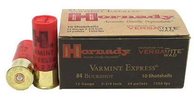

I patterned my Remington 870 (18" barrel, 2 3/4" shells, open choke) with 00 buck, #4 buck, and #4 bird. At 10 yards The 00 buck (Fiocchi Exacta, Reduced recoil, nickel plated) gave 6-8" patterns, the #4 buck (Hornady Varmint Express, Versatite Wad) gave 4-5" patterns, and the #4 bird (Winchester SuperX) gave 12-17" patterns. The #4 buck was promoted as having a special shot cup that delivers tighter patterns.

You probably should be aware of a shot-cup called Flight Control wad. Hornady sells the EXACT same thing, but they call it a Versa-Tite wad. These specialized waddings are designed to keep the shot pellets together over much longer distances. If you are shooting buckshot over long distances (40 yards) then you need to use a Flight control or Versatite wad.
Most 18 inch barrels have a cylinder or modified choke. These are ideal for Flight control or versatite.
If your gun has replaceable chokes, such as full, you do NOT want to use flight control or versatite wads with a full choke gun. Your pattern will actually be worse. Full choke is for regular shotgun shells that lack versatite wads.

Thanks for getting back. I have the load for you.
Hornady #86243 is #4 buckshot with their Versatite wad. This load is really good at long range, and perfect size for dog size critters. Thats what I would load for dogs at 10-50 yards.
No, not 4 buck, # 4 lead bird shot with #2s and BB as a second and 3rd choice. Dogs are thin skinned and not very thick. At 40 yards, even with #6 bird, he won't come back for more, He will either lie down and bleed out, or his buddies will look after him in short order.
"Thanks for getting back. I have the load for you.
Hornady #86243 is #4 buckshot with their Versatite wad. This load is really good at long range, and perfect size for dog size critters. Thats what I would load for dogs at 10-50 yards. "
That looks good.
As always, thank you.
