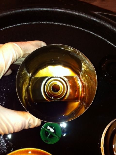

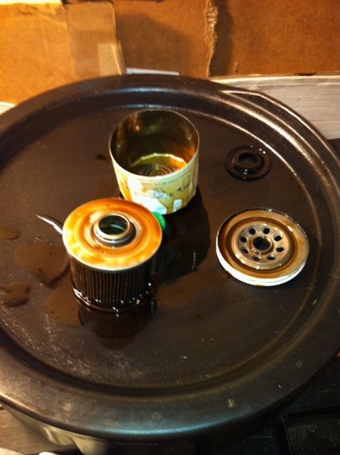

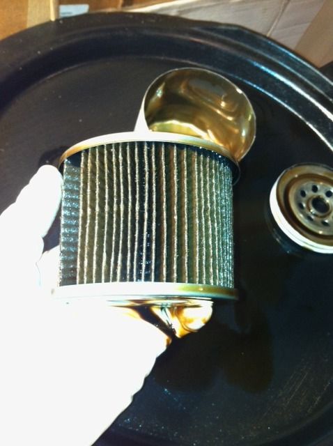

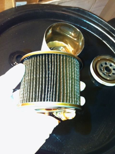

Here is a filter I took off a friend's Jeep. He also has a 2000 Cherokee 4.0L, but his only has 132k miles. This filter was run with Pennzoil Conventional 10w30 for 5,000 miles.
His driving style is similar to mine, with mostly short trips and the occasional highway run.

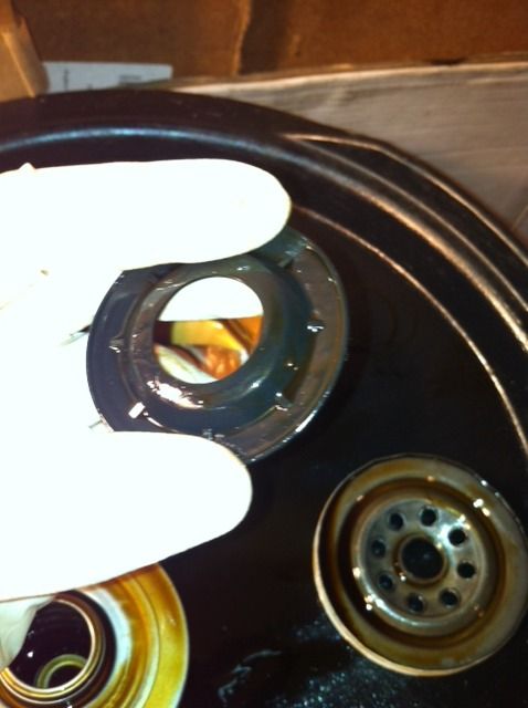

The ADBV was definitely not as flexible as the silicone one I had in the FL-400s filter on my Jeep, but it was still in good shape and worked well. There were no start up noise issues throughout the OCI.

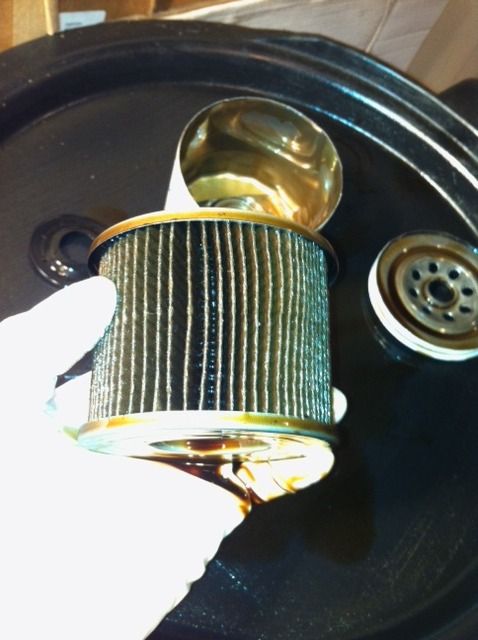

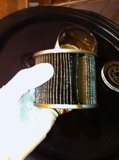

Media:

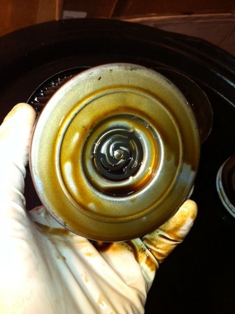

Bypass:

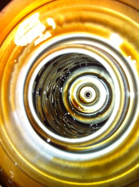

Center tube:
For a little over $3, I think this filter is worth it. In the case of the 4.0L Jeep, the Motorcraft FL-400s can be had for only a bit more money, but these Purolator Classics are definitely a good bang for the buck.
Looks good ... and the oil looks pretty clean for 5K miles. His engine must be in tip-top shape inside.
Good filter on the cheap; especially for 5k oci on a well cared for engine. I use the classic on my Camry and 7k OCI and also on my Brute. They do well for the cost.
I used this same filter in my Dodge.After cutting one open, I found a half inch tear in one of those "wide" spaced pleats.I have since stopped using these products and switched to Wix.Puroator states there is no difference but I noticed a decrease in quality(fewer pleats and no metal pleat crimp) when the model changed from Premium Plus to Classic.
For $3.27 for 5k, tough to beat. Looks like it did it's job. And apparently not all 4.0L Jeeps have an issue with start up noise using a filter with nitrile adbv.
Looks great, very good affordable filters no doubt and a top pick. Unfortunately those are on my loooonnnngggg list of filters that give me start up noise on my Jeep, but my Jeep is NOT typical. I ran whatever I wanted on my other two Jeeps and my buddy with the XJ can run anything he wants as well.
Good job, as always thanks for cutting and posting!
