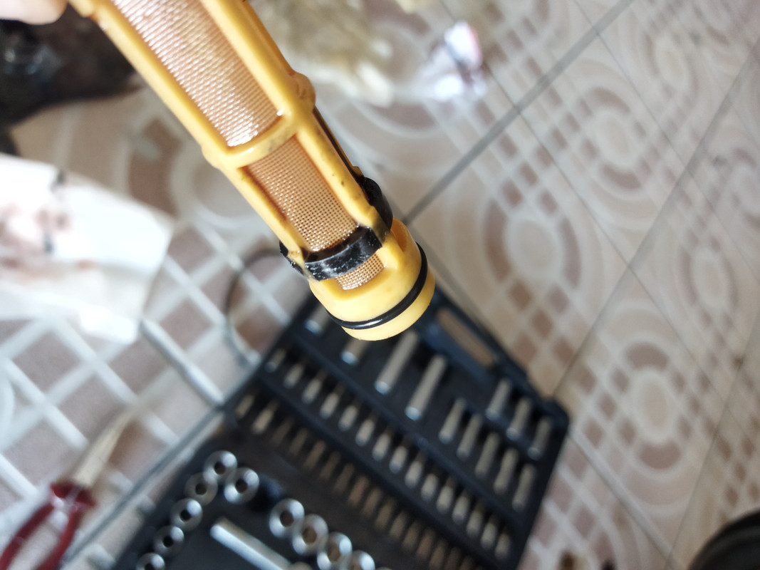

Update:
Just did the service on this motorcycle.
And the magnet on the oil strainer looks like this:
It's the second service in which I use the 10w50, and the second service where I find the magnet with small filings.
I have no memory of the 20w50 giving me filings.
Could it be the 10w50 shearing that much?
No reason to suspect the shear...
Shear Stability is a measure of the amount of viscosity an oil may
lose during operation. Oil experiences very high stresses in certain
areas of the engine such as in the oil pump, cam shaft area , piston
rings, and gears or any other areas where two mating surface areas
squeeze the oil film out momentarily... but technically speaking as
our oil shears down we don't see elevated wear rates because oil
analysis shows as viscosity shears down the flow goes up and the
concept of lubrication states the greater the flow the greater the
protection..

What that statement doesn't address is the fact that as motor oil shears down in viscosity it also reduceS the miniumum oil film thickness (MOFT) between moving parts. If oil shears down too much, under certain circumstances the MOFT can become zero and metal-to-metal contact and wear will occur.

Blackstone Labs address your claim and didn’t discover any significant differences in wear, regardless of oil thickness...
The Importance of Viscosity?
Quote Blackstone Labs
The viscosity, or thickness of the oil, is not nearly as important
as many people think. Oil retains its nature no matter what thickness
it is.Think about this: automakers are continually recommending
lighter multi-grade oil in new engines. The reason is increased
efficiency. It takes power to pump oil through an engine, and the
lighter the oil, the less power required to pump it. The oil’s ability
to act like a solid and protect parts is not related to its thickness.
If that doesn’t sound quite right, consider this: The gears in a
heavy duty Allison automatic transmission are doing the same work as
the same machine equipped with an Eaton manual transmission. Due to
the hydraulics of the automatic, it runs on a 10W automatic
transmission oil.But the manual transmission uses a very thick
(sometimes up to 90W)gear lube oil. The gears of both types of
transmissions will have a similar life span. We don’t find any

As I've said before ... Blackstone Labs is not an engine study lab focused on tribology. I think I'll trust the people/engineers that have actually done controlled studies on the relationship between engine wear and viscosity/oil film thickness.

Studies do add to our knowledge but so does Blackstones Labs 36 years worth of real world database averages for comparing wear...
