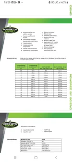

Add the Hotshots Shift Restore! Works in all Atf/CVT fluid. I use it in all these Honda CVT transmissions. Try a filter replacement as it's possible the filter is overloaded and restricted flowing. It's 90 percent Group V and if you add the mix at 7.5 percentage it also does other things.
