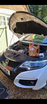

Car - Honda Civic MK9 1.6 I-Dtec
Oil Out - Some Honda dealer C3 oil.
Filter Out - Genuine Honda oil filter.
Oil In - Shell Helix Ultra ECT 0W30 C2/C3
Filter In - Genuine Honda oil filter.
Undertray was a pig to remove. Felt like the tiny cross head bolts had been rattle gunned tight by the Honda dealership previously. No anti-seize or signs of worn bolts being replaced at all. Hence my total reluctance to ever use main dealers.
