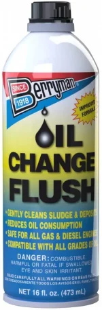

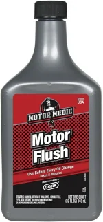

5-15 Minute flushes used 3 times so far during an oil change, zero effect. I'll include the products used below.
61muGu2R8qL._AC_SL1437_.webp71bO0nVK1mL._AC_SL1500_.webp84c277c1-8bf6-4fa2-9389-bb854d17d100_1.b1ab53971d3e3b5d027e811b1a14a294.webp
