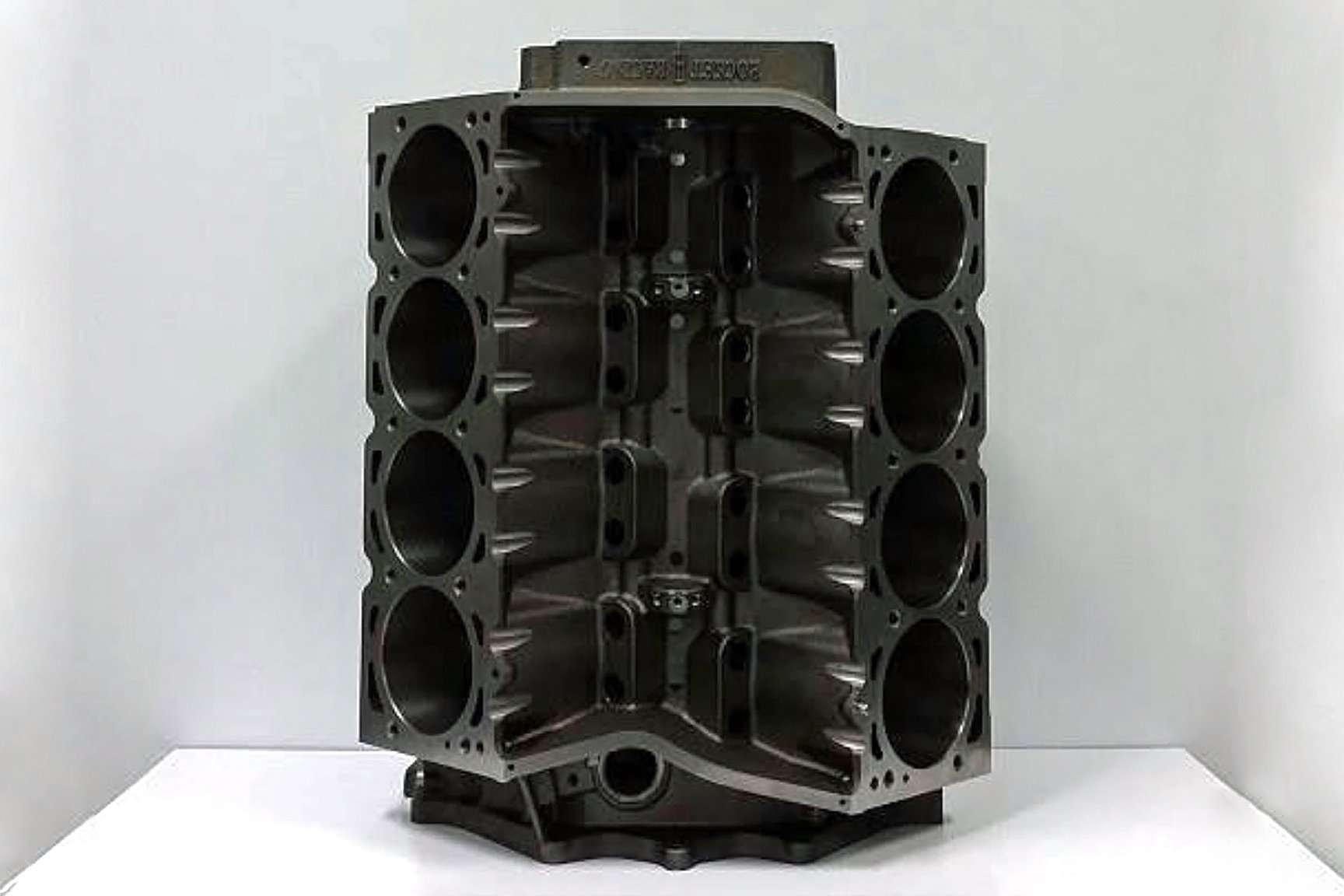

The 350 Olds diesel blocks make a great race engine platform. Will except big bore and is a thick reinforced block to begin with. Most were in the bone yard after 3 or 4 years so hard to find now…
